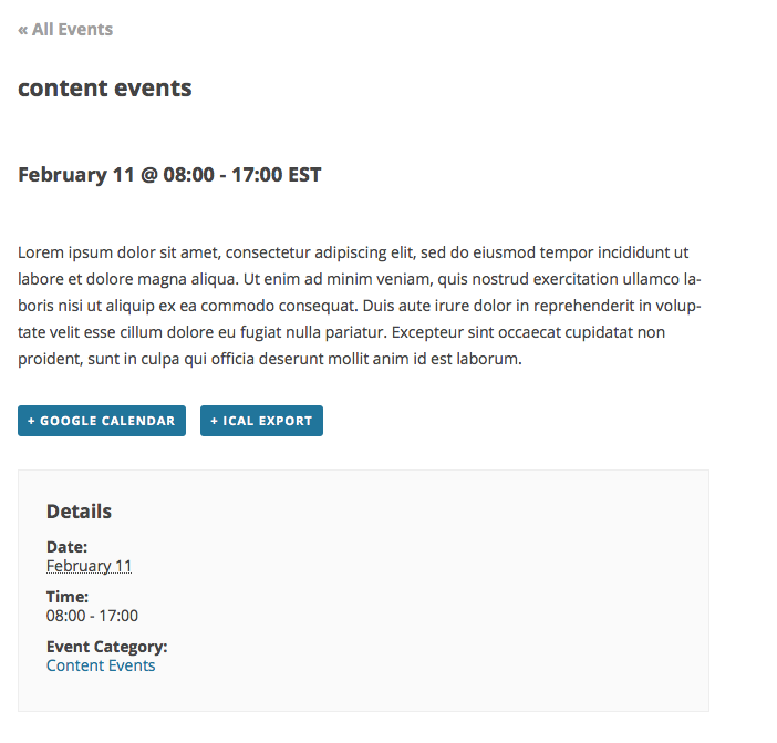

To demonstrate the approach I am recommending here, let’s start with a screenshot of a “normal” event that is in a category called “Content Events”:
To hide the “date” on events like this that are in the “Content Events” category, but leave all other events displaying normally, add this snippet of code to your theme’s functions.php file:

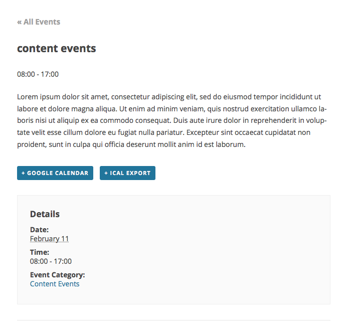

Here’s an example of how that originally-shared event would now look:
