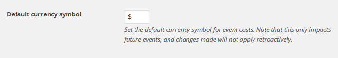

    Have you changed the “default currency symbol” in your Events Settings to be kr? Here’s a screenshot of the option I am referring to:
    That is the only “out-of-the-box” currency control we have.
