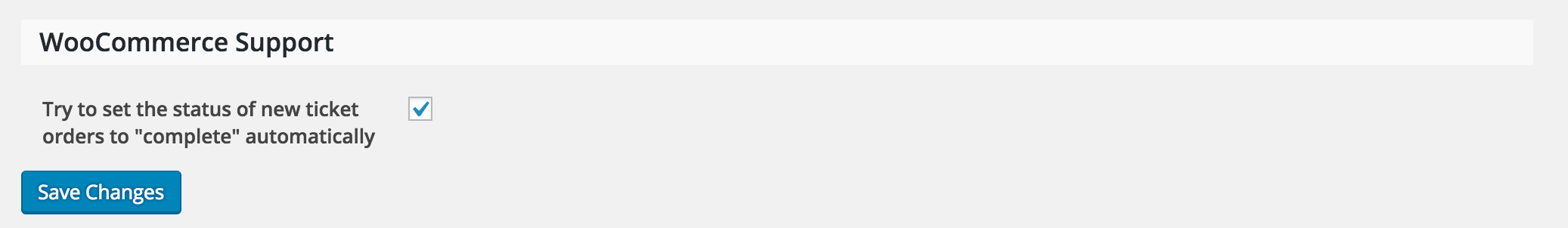

    What payment options do you have available? Have you noticed if the order doesn’t get marked as complete depending on which type of payment is being used? If you haven’t already, visit Events > Settings > Tickets and check the box under WooCommerce Support.
    If that doesn’t work, there is an Automatically Complete Orders snippet available from Woo. Let me know if it helps.

    Will the snippet interfere with that checkbox? I do have that checked but it didn’t seem to work.
    #1116542
    The snippet will override the setting regardless if it’s checked or not. Let me know if it does the trick.
