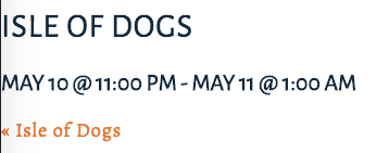

    did it again, here is a link to the live event post. I will delete this post after 24 hours or when I hear from you
    https://thebaytheatre.com/event/isle-of-dogs-2-8/

    So this event was supposed to start at 9pm?
    Brendan
    #1528683
    Erik
    it was supposed to start at 7pm

    See below for the Isle of Dogs event. I took this out of your ics file you sent and it shows the start time of 2300 which is 11pm. So not sure how thats getting mixed up on the Google Calendar end but when our system reads this ics code its 11pm. In the header of the ics file the timezone shows America/New York, is that the timezone you are targeting?
    SUMMARY:Isle of Dogs
    TRANSP:OPAQUE
    X-APPLE-TRAVEL-ADVISORY-BEHAVIOR:AUTOMATIC
    END:VEVENT
    BEGIN:VEVENT
    DTSTART:20180505T230000Z
    DTEND:20180506T010000Z
    DTSTAMP:20180525T143037Z
    UID:6B6E514F-FFCD-44CE-9641-0D369DEA5404
    CREATED:20180424T170816Z
    DESCRIPTION:
    LAST-MODIFIED:20180424T170816Z
    LOCATION:
    SEQUENCE:0
    STATUS:CONFIRMED
    TRANSP:OPAQUE
    END:VEVENT
    BEGIN:VEVENT
    DTSTART:20180506T230000Z
    DTEND:20180507T010000Z
