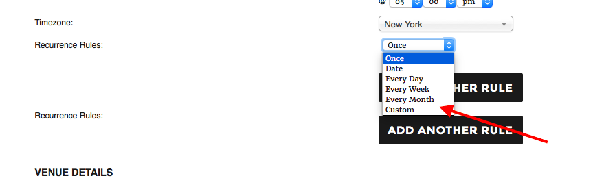

    And here’s a screenshot of the result on my local testing site to show it working as intended:

    Thanks for your response and recommendation. I really appreciate you putting this Javascript snippet together! I tried it out and it does work perfectly for removing the Yearly option from the Recurrence Rules dropdown. The only other aspect of removing the annual recurrence option is removing Yearly from the Frequency dropdown. That can be accessed by choosing Custom from the Recurrence Rules dropdown.
