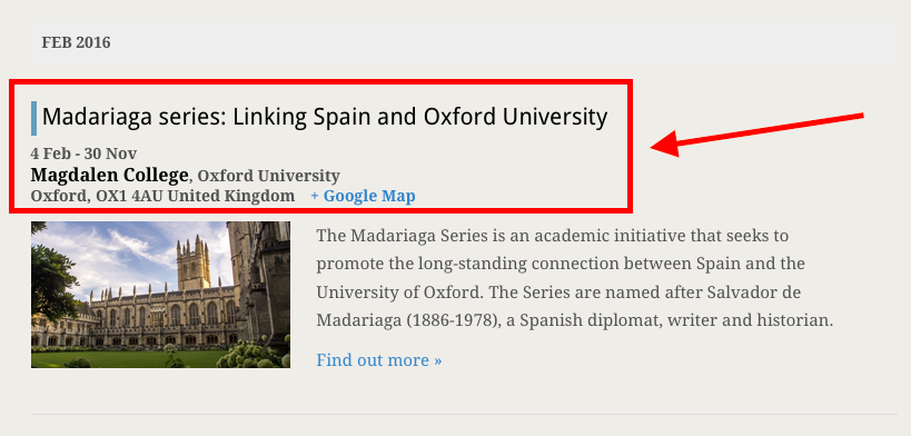

    Just to be 100% clear, are you referring to the block of event information that is seen right under the List View event title? What I mean is the block of text that I’ve highlighted here with the red box:
    ☝️ I just want to ensure I understand your goals so that I can best help out here!

    Hi George, yes that’s right. I want to edit this block on list view mode
    I want to edit this block to keep consistency with the rest of (already edited) events views on the site (as in photo view or single event)
