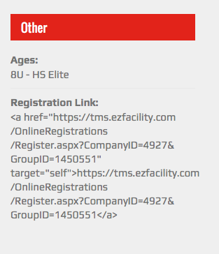

    I’m using a Custom Field / URL in my calendar and the display is broken. I’ve seen the couple of similar reports here on the forum, with your recommended fix to hack a custom PHP file to make it work. Is this bug to be fixed?

    The issue is that esc_html(), as the function name implies, escapes HTML, and so sometimes with links it will output the full link tag instead of just showing the URL. And so we have the issue on your site as shown in this screenshot:

    Sorry for the additional post here! But upon closer inspection I realized I made a mistake above – while what I shared above may indeed still be of help here, your main file change should ACTUALLY be this:
    1. Create this file in your theme:
    [your-theme]/tribe-events/pro/modules/meta/additional-fields.php
    2. Use the contents of this Gist as the contents of that file → http://git.io/vBQGN
    Sorry about the mixup on my end here 🙂
