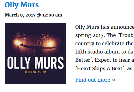

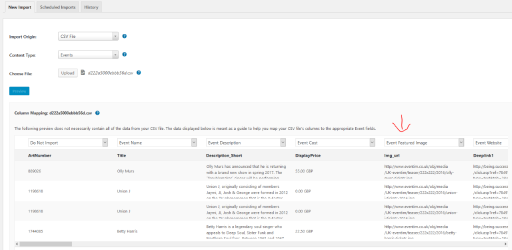

    When I import your CSV file, then I map the Img_url column to be the Event Featured Image, and that does the trick:
    Cloudup hr5nt01amia
    Result:
    Cloudup sijo332l22k
    If you have a specific Meetup feed, then please share with me so I can test that.

    Ok nearly there.
    On featured image. This is what I am doing but its not being imported to mo my site (
    I have noticed when I open any event that has been imported to my site to edit there is no link on the right to change featured image. I can give you access if you like ?

    That’s weird, because for me it downloaded the image.
    Do you see the images in your Media Library?
    When you set up the import first time did you import the images as well? I’m not quite sure how it works after you update your import, or if you re-import.
    What you can try is delete all the imported events (or just a couple for a test), remove them from Trash / Ignored and then import them again. Maybe give ‘Olly Murs’ a try, that for sure worked for me.
