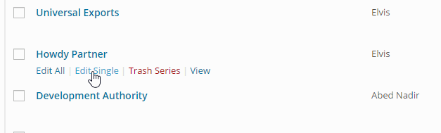

    Good question Henrik. I was using old terminology. It is not called the “Edit Single” button, which can be found in WP Admin > Events > Edit Events. Hover over a recurring event in the list for “Edit Single” to appear, like this:
    break-event
    Does that make sense? Does the above tutorial now work for you once you use the Edit Single button?

    Yes i can do that but it doesn’t break it from the rest of the series… :-/
