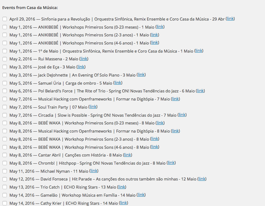

    In the meantime, I was wondering what you find when you click the “Facebook” tab in the Events → Import page in your wp-admin? On this page, there should be a list of event titles from the pages you supplied, like in this screenshot:
    Do you find that your page looks something like that?
    #1108557
    André
    Hi! Thanks! Yes it does looks like that.
