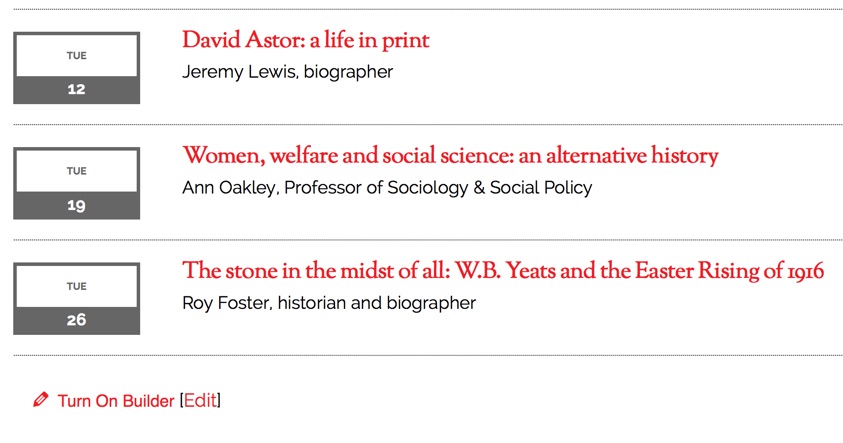

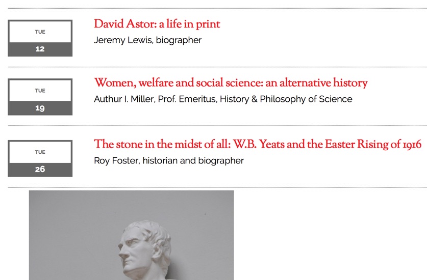

    An odd one: I find that IN CERTAIN CIRCUMSTANCES an ampersand ( & ) in an ‘excerpt’ field causes list widget display to corrupt.
    In the following example the ‘&’ between the words ‘History & Philosophy’ is causing a problem with a photo, which should be in a sidebar top right of the page displaying underneath the list. When replaced with the word ‘and’ the list is correctly displayed.
    Authur Miller
    HOWEVER if the summary text in the SAME entry is edited to have an entirely different summary which includes an ‘&’ there is no problem!!
    Anne Oakley

    So in two of your templates (but for the problem at hand, widgets/modules/single-event.php is the one that matters) you do something along these lines:
    $excerp = tribe_events_get_the_excerpt();
    $printexcerp = substr ( $excerp , 0 , 75 );
    echo $printexcerp;
    The problem is that slicing the string to precisely 75 characters can break a number of things.
    It can, for instance, slice an HTML entity in half. It could also slice opening or closing HTML tags in half – and that is what seems to be behind the problem here (if you inspect the HTML source of one of the pages with this widget you’ll probably be able to identify exactly what I mean).
    To cut a long story short, I’d strongly recommend revising that section of code 🙂
