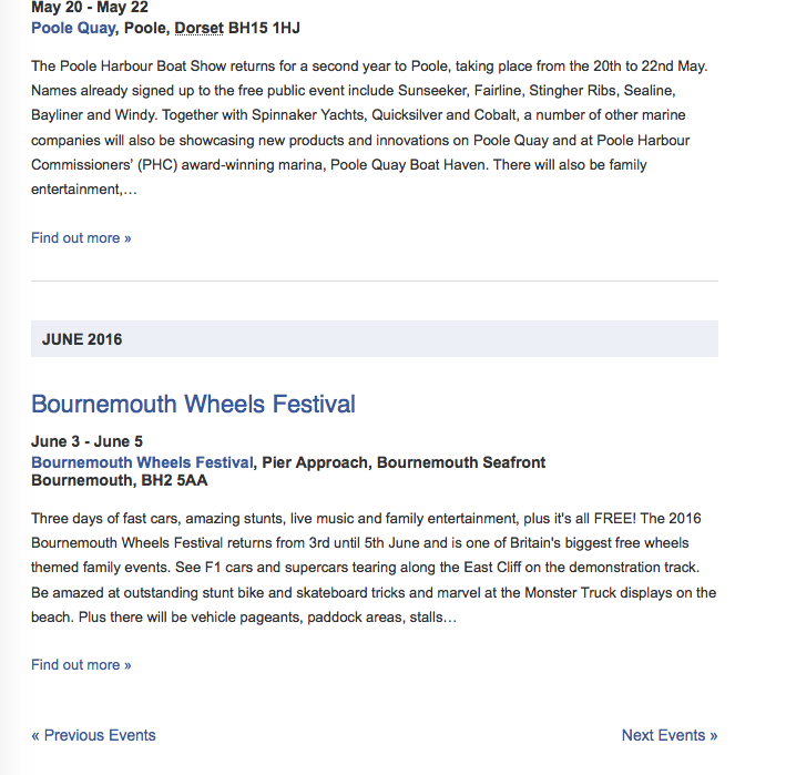

    One thing I’m curious about is if this is supposed to be visible on your site – I checked out the link you provided but cannot see the issue you describe, as shown in this screenshot:
    If you have temporarily rolled back to earlier versions or something like that, would you mind re-updating or just otherwise ensure this issue is still visible on your site? I am sorry to request this! I know your site is a live, active site. However, if you do this I will be able to see the exact problem.

    The issue doesnt occur on every event – it depends how far down the actual event listing I have put the adsense unit. If you scroll down on the main whats-on page to April 2016 you will see the three events under that show part of the adsense code. This is obviously because the adsense units are higher up on those event listings.
    I hope that makes sense!
