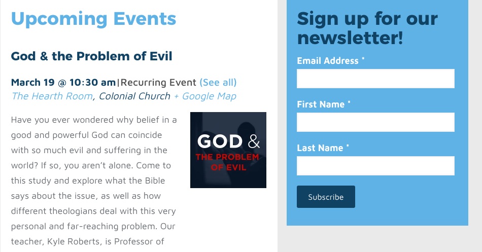

    Hi, I just purchased this plugin and am trying to replicate some of the showcase examples. The attached screenshot shows the calendar in list view on my homepage, using a shortcode.
    Basically, I just want the featured image to be a small thumbnail inside the box, and the date/times to be larger. I have minimal knowledge of code. Thanks!

    #1251906
    Kelly
    Thanks so much Geoff. It looks like I was using the wrong list shortcode, so now I have images, but it’s still not quite how I’d like.
    Is it possible to mimic either of the attached images from your showcase? (ideally with the image on the left)
    (found https://theeventscalendar.com/showcase/chicago-area-yoga/ and https://theeventscalendar.com/showcase/santa-cruz-museum-of-art-history/)
    I’d prefer the image to be to the left of all of the text.

    Thanks Geoff, I am wanting the image to be to the left of everything, so the text would not be above the image, but to the right of it, like the earlier attached example.
    Currently on our home page, the event title and date/venue are displayed above the thumbnail image, but we’d like it to show/float to the right of the thumbnail.

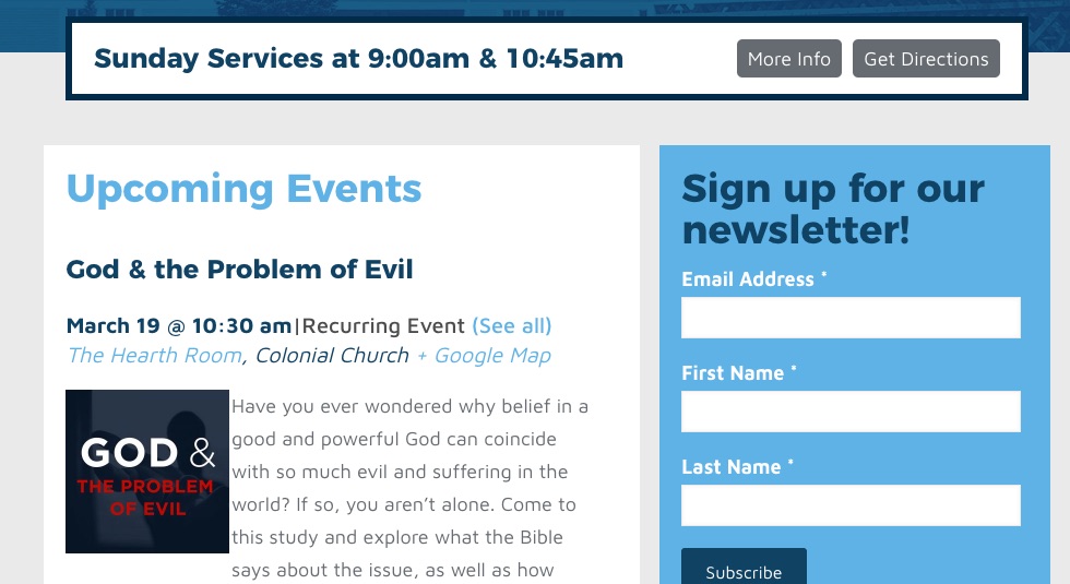

    #1253961
    Good afternoon Kelly,
    Thank you for writing back and clarifying.
    On my end I am seeing the image floating to the left of everything (not to the top – see screenshot)
    In any case try slightly tweaking the following CSS rule to your style.css file or in your Custom CSS metabox by adding the last line (float: left) to make sure it sticks on all browsers:
    .homecal .tribe-events-list .tribe-events-event-image {
    border: 0px !important;
    width: 30%;
    float: left !important;
    You could also make it float right with the following code
    width: 30%;
    float: right !important;
    Let me know how that goes.
