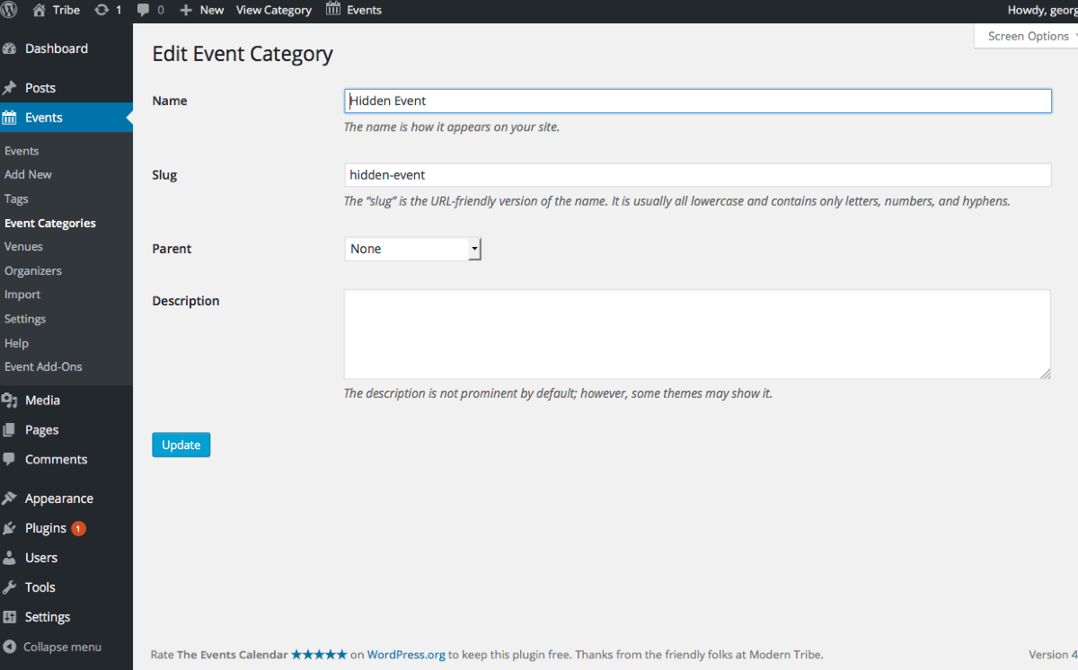

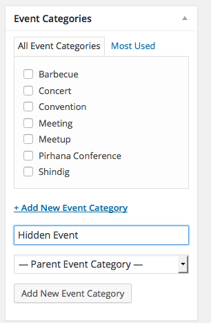

Get started by making a category for this feature. I’ll just use “Hidden Event”, as shown here:

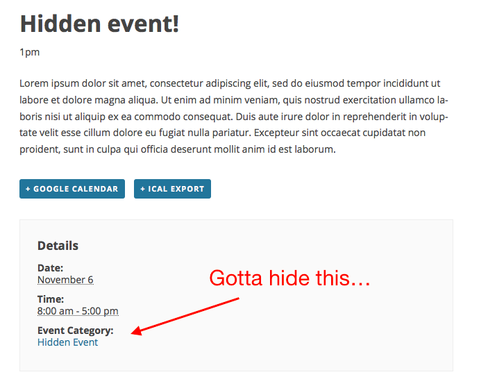

Now, this will unfortunately show up on the single-event views and such, which we do not want:
To make sure that other categories show up normally and stuff, but that the “Hidden Events” category name does not show up, add PHP like this to your theme’s functions.php file:

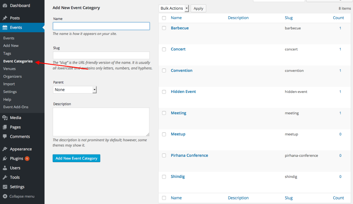

// Change 13 to the term ID of your "Hidden Events" to the proper ID for your site.To find the number you will need to use instead of 13, first just go to “Event Categories” in your admin:
Then, click the specific “Hidden Event” category on your site.
It should bring to you a page that looks like this:
