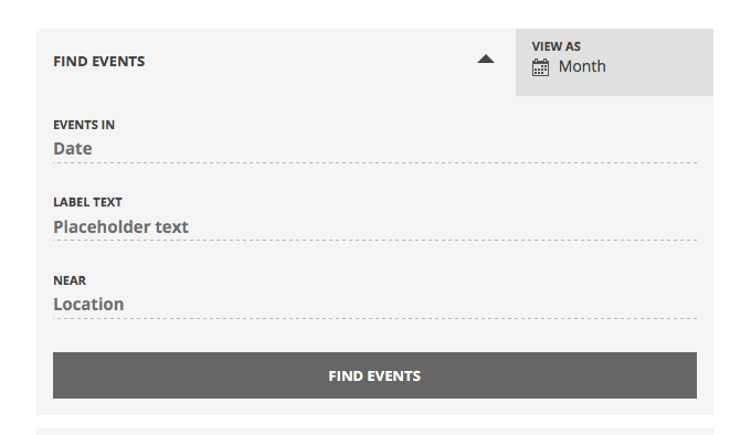

    This snippet will change the label where it says Label text, and the placeholder text where it says that of course. So for example, the exact code above will make this change on the front-end:

    Hi George,
    Thank you so much! I tried this out it is exactly what I was looking for. Thanks again for helping troubleshoot and get a solution for this. Really appreciate your help!
