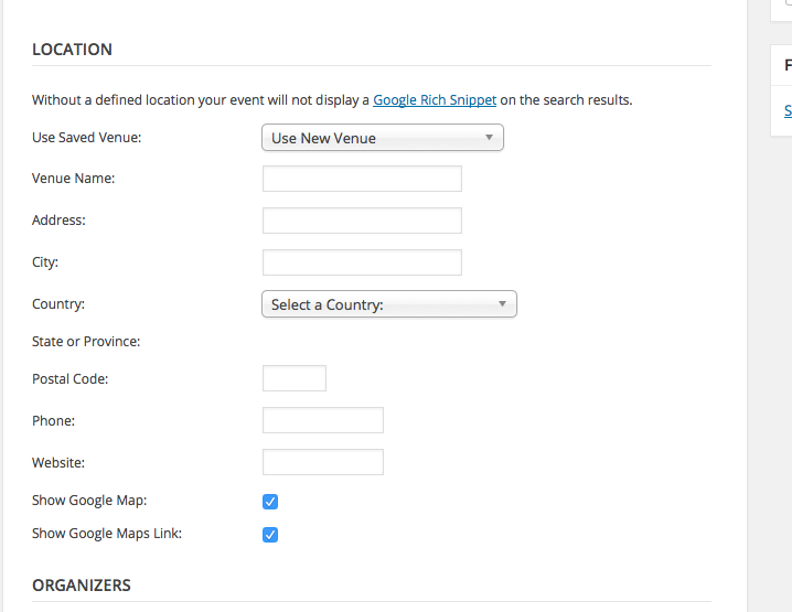

    When creating new events it gives you the option to Use New Venue.
    Is there anyway to remove this so it only gives options of the venues I have already created?
    Kind regards,
    Luke
    #1021415
    Hey Luke,
    Just to be 100% clear, do you mean the venue fields in the wp-admin? These ones, specifically:
    Just want to make sure I know what you’re talking about โ€“ย I’m pretty darn certain this is what you mean but you never know ๐Ÿ™‚

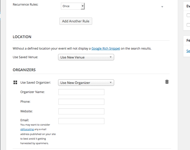

    Here’s how that makes things look for me:
    The dropdown still says “Use new venue”, obviously, but this is unfortunately not so easy to change ๐Ÿ™ You’d have to customize the chosen.js javascript directly which is a bit outside the scope of the forums here.
